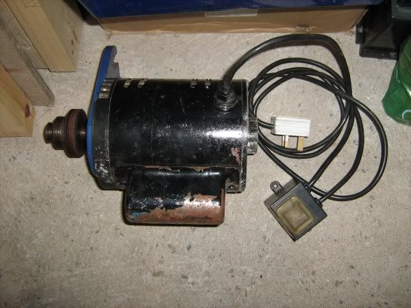

First things first what have I already got to make this a 'goer' or possibility. Well an old induction motor and pulley set
various bits of hardwood, screws etc. etc.
Most of it I've had to buy in though and I'll total it up at the end. Anyway I started off with what has become one of my favourite pasttmes, scouring the net for bargains. This turned up the pillow block bearings, steel rod and a longer pulley belt (longer than the one I had). This allowed me to size things up on the bench

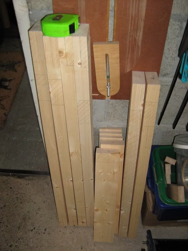

This shows the frame pieces cut to length. Cutting the lap joints on the tablesaw was going to take forever with a 1/8" inch blade. Dado blades seem to be hard to come by in the UK so I improvised. The depth of the arbour on my saw allowed me to double up on blades (6mm or 1/4"). I know this is risky but I asked permission from Autumn's tablesaw Gods and did it up extra tight. Stood to the side and set it running. A minor tinkling sound, which turned out to be a small piece of sycamore trapped in the guard, but no explosions or flying saw blades. I let it run for 5 minutes. Still no problems. With this setup I finished off the 26 lap/halving joints in an hour and a half. Result!
I've lined the struts the bearing blocks are mounted on (and the one the table pivots on) with whatever non-exotic hardwood I had laying about. Oak and Maple. So here's the build so far.
This has taken about three days so far but I'm on holiday this week so who cares

Wow that looks nice, Allways want to make one too.
The problem is I want to much and the time is going so fast.
I have the motor from an old painting machine. Now the rest…....
