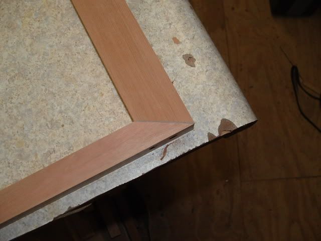

I believe all mitre saws can be made accurate. I have been using a 10" Lowe's/Kobalt slider for years. I ripped a sacrificial strip of maple for an insert in the bed of the saw, removed any and all extraneous "features" bolted it to a homemade bench of MDF, 2X2 with 6X28 inch rif sawn oak boxes on either end to match the height of the saw bed. The box risers are 3 1/2 high, the back riser is 5 1/2 so now I can lay in any stock length and cut to size.
I do check blade square in both directions and always get square cuts with a 60 tooth finish blade. No fussing, I use a 6" Swanson construction grade stair triangle (also available @ Lowe's 6 bucks). Truth be known, there is no blade guard to get in the way of the square; dangerous but there is also no one in this shop but me and I am acutely aware of all risks. Additionally no stock gets crosscut until AFTER it has been dressed minimum two sides even 2X gets planned/jointed; I build primarily in hard maple, walnut , qtr-sawn oak and alder any 2X would be utility stock.
Miters on a Slider: Again the construction grade Swanson does the trick every time. I verify with a scrap cut. A combination of the Wixey Digital and bevel gauge can also be used to dial in a perfect 45^.
After replacing original blade without even trying it, and fine tuning all functions, my 10" slider cuts perfect angles every time. Does not matter if I am framing a deck or a picture, my Harbor Freight is dead on accurate. $79 (second one due to my Son confiscating the first)
