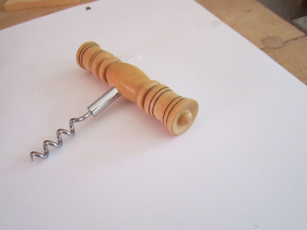

I found a corkscrew handle I like but would appreciate your ideas on how to turn the ball-shaped ends. I've thought of making a jam chuck to hold one end while working on the other, but as far as I can see a hollowed out jam chuck would only hold a straight tenon securely, so once I've turned one end I can't figure out how to reverse chuck it. How would you go about it?

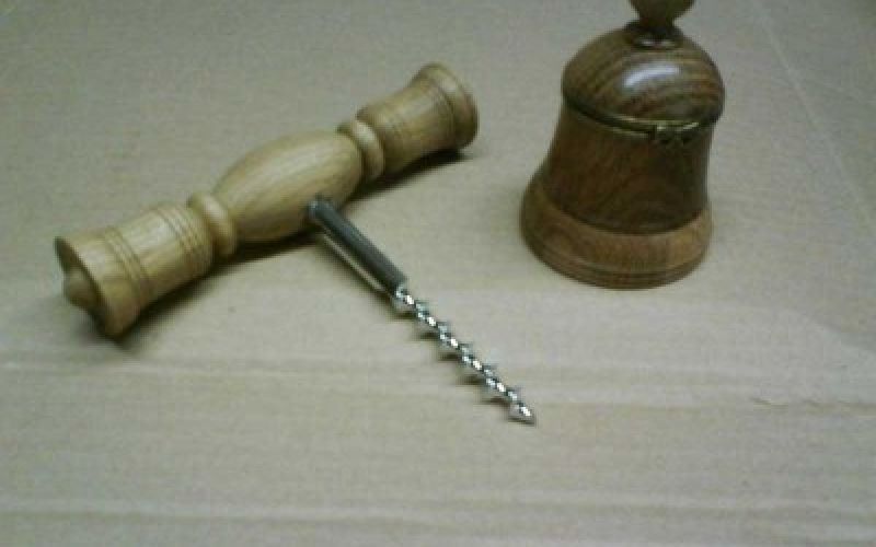

I'm glad we had this little discussion here. I went with the between centers method, using a cone on the tailstock and a homemade thin parting tool, which allowed me to create the slightly concave section on the end and even shape the ball more or less. I finished the balls with a carving knife and sandpaper.
I think it turned out pretty well.
