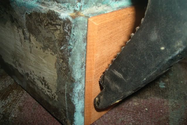

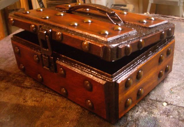

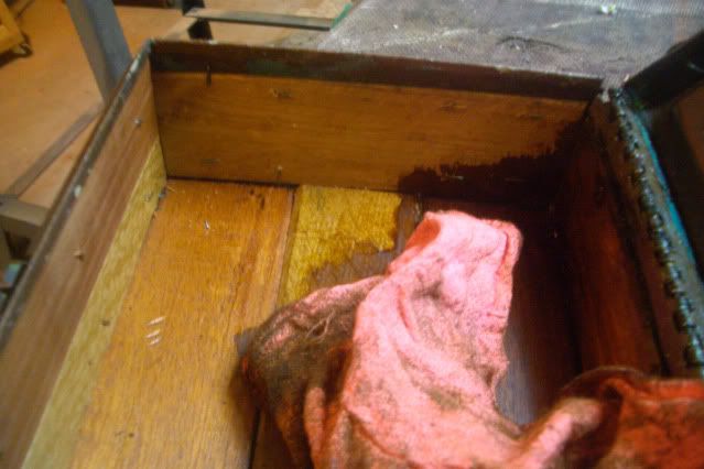

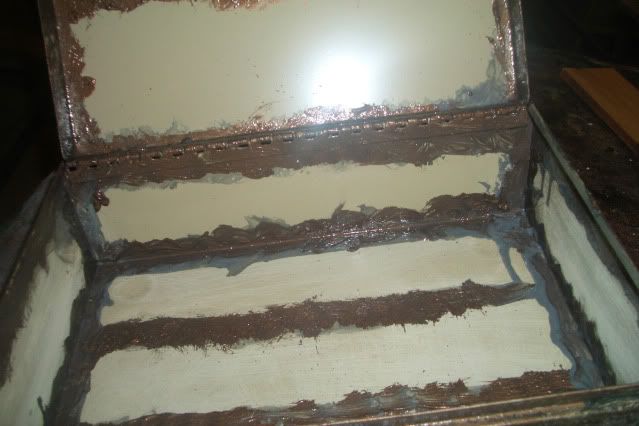

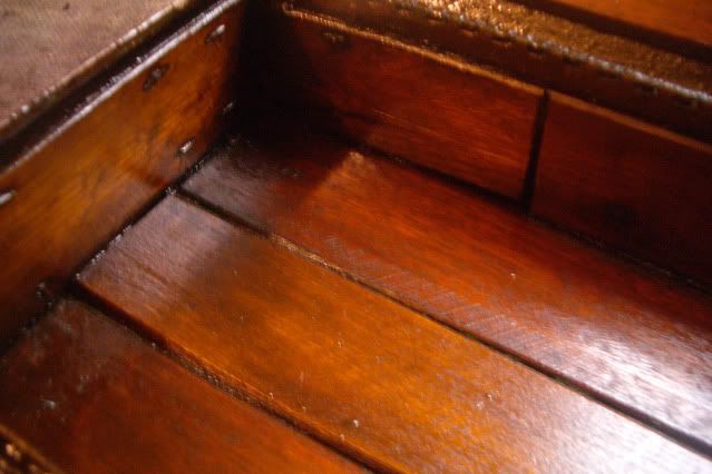

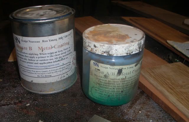

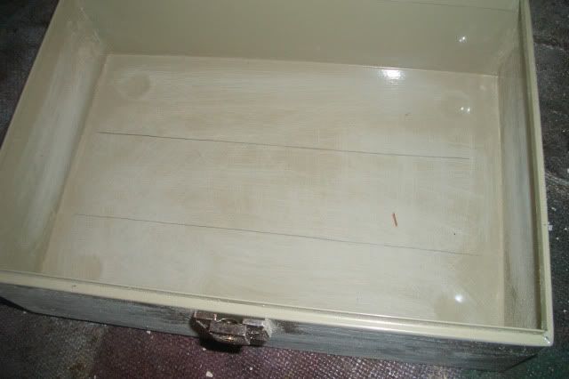

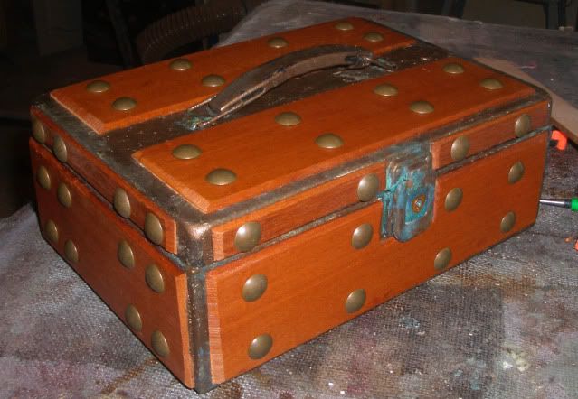

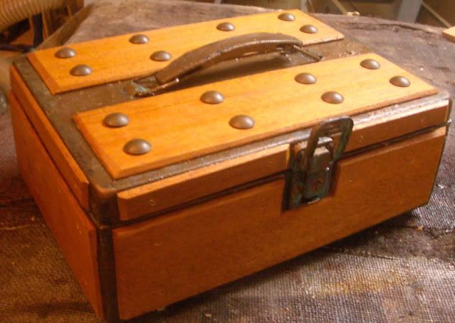

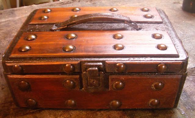

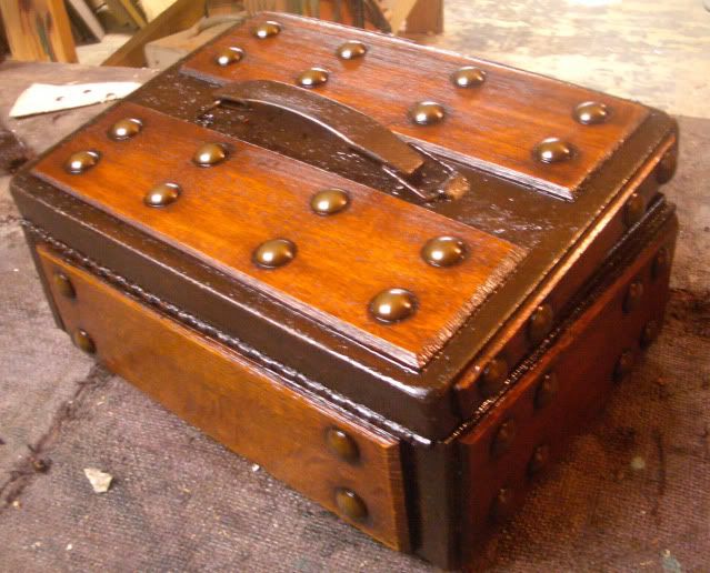

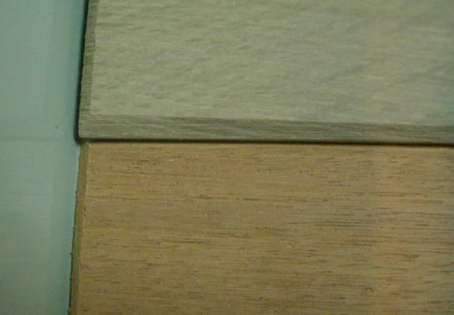

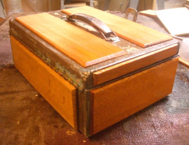

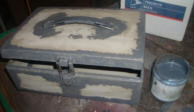

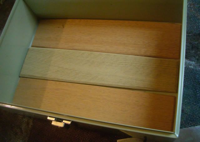

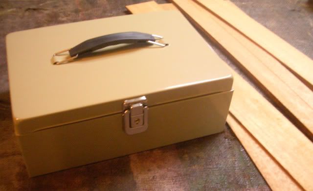

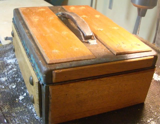

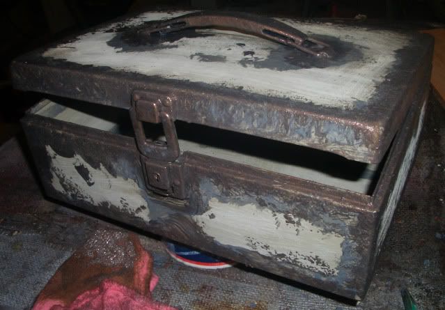

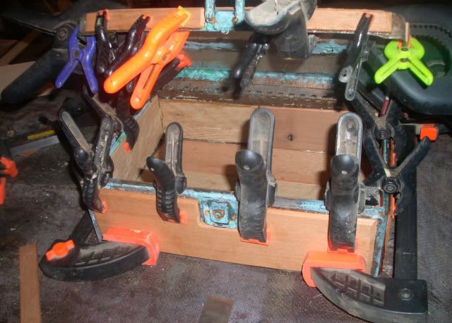

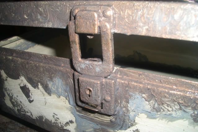

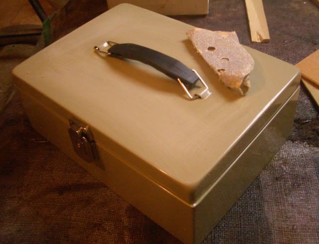

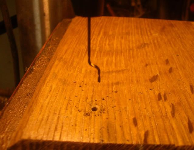

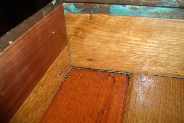

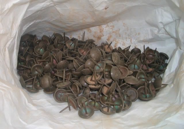

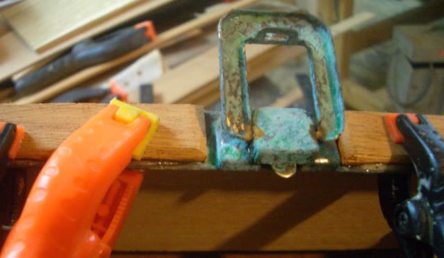

PHOTO BLOG of process
I bought a cool metal cash box on eBay for about $6. Got a wild hair and decided to make a STRONG BOX
honduran mahogany
quartersawn white oak
stickley nails
metal paint
acid patina
beveled edged thins
glued
drilled
clenched the nails
sprayed with lacquer
dark oak aniline dye
jazzed up oil stain glaze
tomorrow will be lacquer,shellac and wax

Thanks Guys ! Not sure about the vision, but did enjoy making it. Nothing was measured. Everything was eyeballed … very quickly made.The paint was the bottom of the can…. gooey … Really set quickly.It drys very hard. Made it in a day…
Nothing too serious ….

this one is pure entertainment … enjoyed every minute of it … kind of lazy today … it is 5pm on a Sunday and I haven't ventured into the shop.
My basement is cool … to say the least and the oil finish isn't quite set in corners.
My next step is to rub down the mahogany and oak inside and out with steel wool and Briwax … tudor ….
