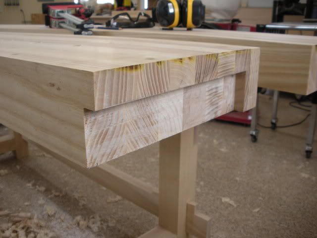

The top is glued up and the components are rough cut
I'm in the process of building a new workbench based on Bob Lang's bench as detailed in the October 2008 issue of Popular Woodworking. I've read Christopher Schwarz book "Workbenches: From Design And Theory To Construction And Use" as well as several others. It always seemed like I wanted a combination of the features I found in most other benches. Bob Langs design was the first I'd seen that incorporated everything I wanted in a bench, so here goes!
I bought 150bf of 8/4 Ash. I ripped twelve 8'x4 1/4" boards for the top. I needed about 2" from each board to make up the 11 3/4 inches for each half of the top. Unfortunately good straight lumber is hard to find and after the Ash got done moving and I jointed and planed it the 6 boards were only giving me about 10 3/4". So I ripped another board milled up another two pieces. Now I'm sitting at about 12 1/2" per side. Since each board was ripped from a single wider piece I decided to "bookmatch" the two halves of the bench. Nobody will ever notice but me I'm sure, but I thought it would be a nice touch with no extra work. Here are the boards:
Then I started gluing up the boards. I started as Bob had advised by making sub-assemblies of two 2×4's and then using wooden clamps on the ends to keep things lined up, but I noticed that even the things were shifting a bit. I decided to change tactics. I started gluing the boards up one by one. Each time adding one more board in the sequence. This did two things for me. It let me work faster because I could glue it up and then after having it clamped for 30 minutes I would take it out of the clamps and add another board and re-clamp. Secondly, By only adding one more board I could clamps some parallel clamps across the boards to keep things lines up as I clamped them together vertically. This was MUCH easier than trying to finagle a twin screw wood clamp to keep things aligned. When I started this method things moved faster and came together very squarely.
After both sections of the top were glued up then I moved on to roughing out the other parts. All the parts are shown here: the bottom rails are closest, then the top rails, then the two halves of the bench top and stacked on that are the pieces that make up the bottom stretchers, the pieces that make up the top stretchers and then the eight pieces that make up the four legs.
So that's where I am now. Hopefully I'll get a little more time in the shop tonight to mill the other components four-square.

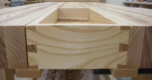

This is very cool. I finsihed a Holtzapel work bench out of hard maple about three weeks ago - 3" x 24" x 96" top. It is marvelous. the top was a bear to handle after all the glue up. I love it and know you will love yours as well.
Are you going to use the Veritas twin screw vise? It is a little tricky to get the two handles aligned. I had to deviate from the directions to get the handles aligned. The directions say to install the two screw fixtures, then install the chain and then screw the two handles in together. Well I did that and the two handles were not even close in alignment - off by 180 degrees. I the took the chain off, turned each handle to close the chop on the bench and had to reinstall the screw fixtures. It would have been much easier to install the screw fixtures after having gotten the handles aligned. I hope this makes ssense because it was a hassle to redo it. I read another on-line blogger had the same issue.
If you are going to use the 7" Lee Valley quick close vise, I ran into an issue there as well. On the rear attachment bolts, I had to add a washer shim between the vise plate and the bench underside. Otherwise, the vise was canted a bit.
Finally, the beeswax/turpentine/boiled linseed oil mixture as a bench finish covered in Woodworking Magazine as the best bench finish is indeed wonderful. It does smell while drying so keep a window open for several hours. It is 2 ounces beeswax (e.g. old candle) to 16 ounces turpentine to 16 ounces boiled linseed oil. My wife shaved the candle on a grater to get fine particles that would dissolve in the turpentine. I heated the mixture in a bath of hot water to get it to totally dissolve. It is a gel at room temperature. i heated it in warm water before applying it and applied three coats over three days.

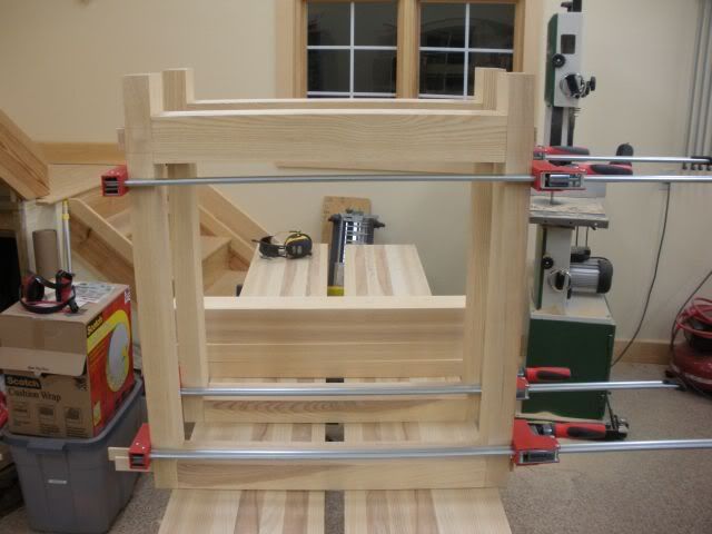

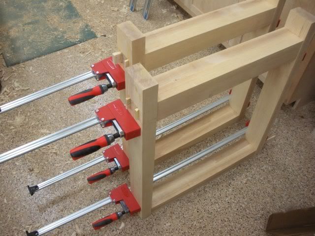

Shannon, One additional thing about the glue up. In photo above you'll notice that all of the clamps are on the same side of the slab - this is the first slab. On the second one I alternated the clamps. I don't know why I didn't do it on the first one, but it also helped keep things square. Even though the clamps are supposed to be parallel, they still tended to pull the board toward the clamp ever so slightly. Alternating them completely eliminated that tendency.

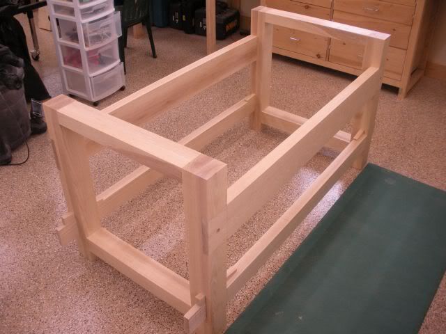

Mortise & Tenon's are rought cut
I got to spend a few hours in the shop yesterday and I got the top planed although I discovered that one half of the top has developed a little twist. I'll wait until it's attached to the base and in position before I worry about hand planing it flat. I got the mortises chopped out and the tenons rough cut. Here's where I sit now:
377 Posts

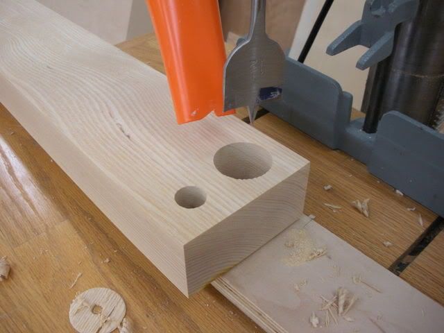

Looks great. How did you cut the mortises?
