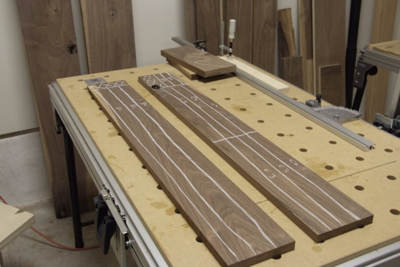

Evaluate grain and layout parts
It's hard visuallizing which grain pattern will look good for which part of the project. I hope this is one of those things that will become easier with experience.
You'll know whether you like it when you lay it all out how it'll be arranged…

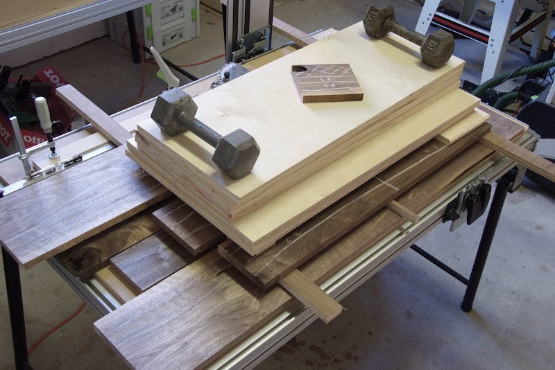

Milled stock square 4 sides
Here's all the stock milled s4s, marked, and semi-stickered ready for ripping and cutting to length. I read somewhere to let milled wood rest couple days before working it.
Stickered and weighted.

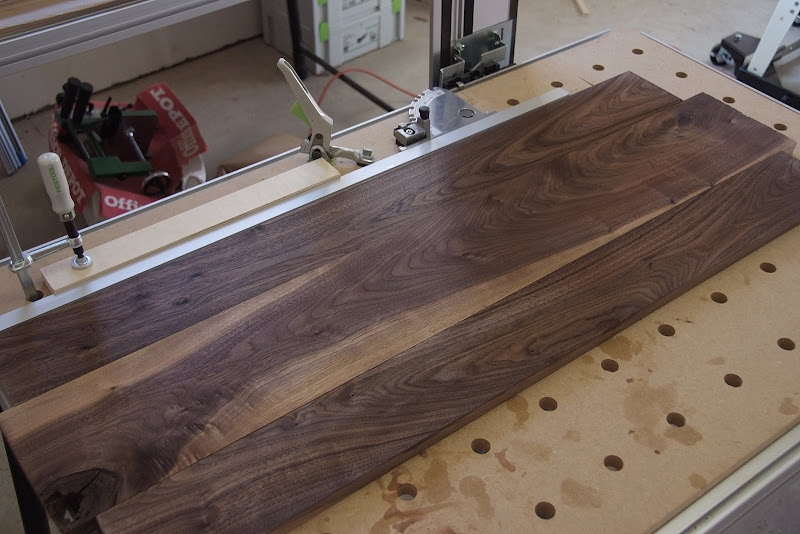

Pieces for the top piece
Here are the pieces i milled up for the top. I tried to go light on the jointer/planar because i need the top to be as thick as possible. I think I ended up with all pieces being 7/8".
Beautiful planks, very interesting grain pattern in them.
The center board looks as if it has some quilting in it?
-Ray
Yes, some of the boards have a little figure… wouldn't call it quilted but it does add a bit of interest. Being that it's a bookcase, the top won't actually be the "show piece" but the chatoyance would be a nice surprise for those who do look for it. :)

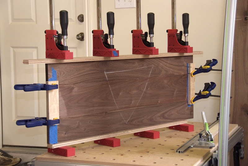

Glue up the top
The top pieces have been chosen and in the clamps for glue-up as we speak. The domino tenons helped keep everything aligned and flat for the clamping. I cleaned up the squeeze out and will let it set while i work on the face frame and doors.
Glue up the top
Looks good so far. Pretty wood.
