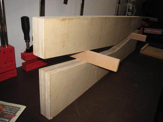

Aloha everyone, time for my first blog entry. I recently started stand up surfing and when searching for paddles, I was directed to Bob Babcock's postings. I was totally blown away and inspired! I set up my account, contacted Bob, and off I went. OH, thanks again Bob, I talked to Bill and will be paddling in Maui next month!! I hope to see you there.
Below is the jig that I made by gluing up two layers of 1/4 inch ply between two outer layers of 3/4 ply. I cut the jig into two pieces so I would be able to bend the shaft at 14 degrees. I expect the final angle to be about 13 degrees after the wood relaxes some out of the jig. You can see how huge the thing is, but I hope to make a few paddles, so I beefed it up quite a bit.
Side view of paddle bending jig
Bending jig with clamps

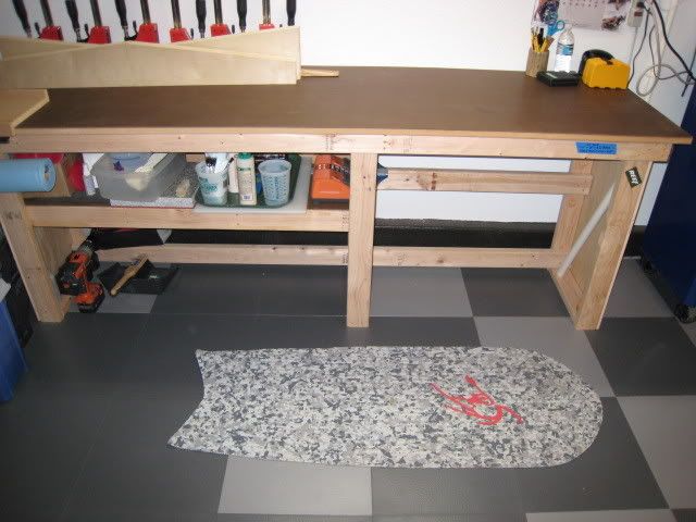

The matt on the floor is a traction pad for my stand up board. I put a larger one on and put some no slip material on the bottom and now I have the coolest anti fatigue matt ever!
Bench Mat SUP style

Somebody went and put a workbench under that calendar.

Yeah, crazy huh…

Very interesting. Man, that is a great calendar!

Hehe…glad to see I'm not the only hound dog in the pack….nice calendar. Oh yeah….the jig looks good too…:)

I said, "what calendar?" hadn't noticed it… men!
nice bench and the jig is interesting.

Thanks MsDebbieP, I was starting to think that my workbench and jig were display racks for the calender! The bench is just 2×4 MDF and Hardboard, but the huge worksurface is great for pretty much everything!

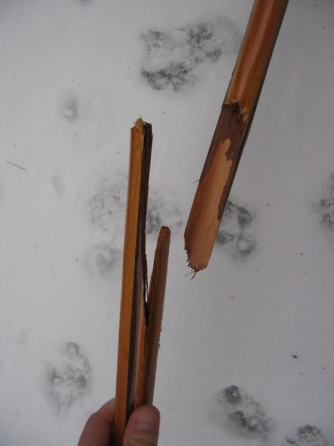

I snapped my paddle today. As a result I'm not sure the Titebond is the way to go. I think I'll be sticking with epoxy from now on. Hope you haven't glued up already.
I think the culprit may be the titebond III. At the center of the crack it looks like it split at the lamination.
It was at the thinnest point on the shaft (1" dia) between my hands
Have you been on standupzone.com? Great forum with lot's of good info.

Thanks for the heads up, but I have already glued up with TiteBond III. I got ahead of myself, and glue up three total shafts. On the first one, the part below the bend spread out, (too much pressure) and made it unusable for a stand up paddle. I am thinking about cutting the bend off and making a wall decoration paddle. I had the strips cut and decided to go ahead and glue up two more shafts. They came out just the way I wanted, so I'll clean up the glue, add the blades and the grip pieces.
I plan on making the shafts an egg shape for as much of the shaft as humanly possible, so hopefully that will add some strength. I hope these will last with the glue, but I will use epoxy in the future for assembly. If the break, at least I am learning how to do it better. I still haven't decided on how to attach the blades, maybe dowels, or a spline or even a series of biscuits.
So, I have to ask how did you break your paddle, were you out paddling in Cape Cod Bay (maniac!), or were you helping the Pats beat down the Chargers?
Yeah, standupzone is good, and so is standuppaddlesurf.net…there is an article called: C4 Guys Stand Up Paddle Surfing Big West Side…Makaha here on Oahu..it's pretty insane.
