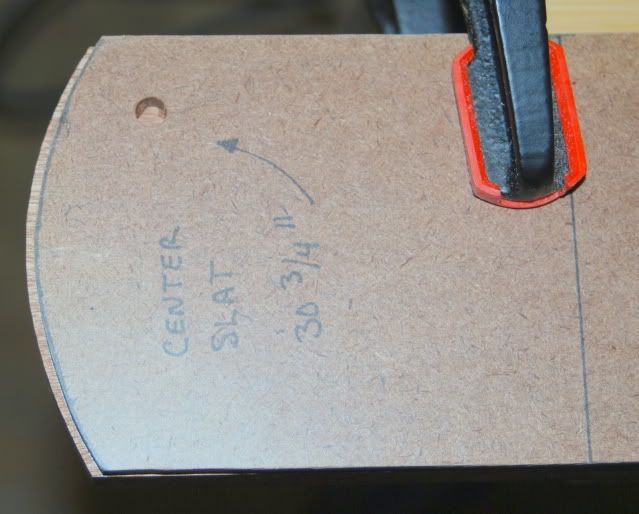

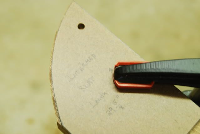

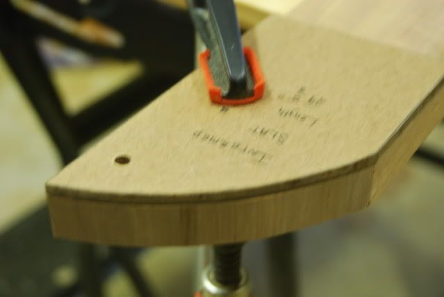

With the first chair, we made templates of the chair components out of hardboard, so you'll be seeing those throughout.

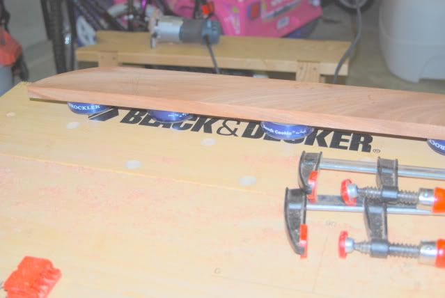

So here is one of the templates and the seat slat before using a 3/4" templating bit with the Bosch Colt. The Colt is quickly becoming one of my favorite tools. Easy to maneuver, lightweight. It's the best.

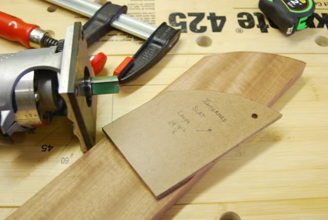

Next, I clamp the template in place and routed the curves of the slats. You can see the bit of the curve left proud of the line on the bandsaw.
The same technique on the center rear seat slat.

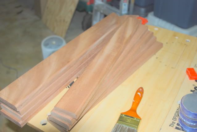

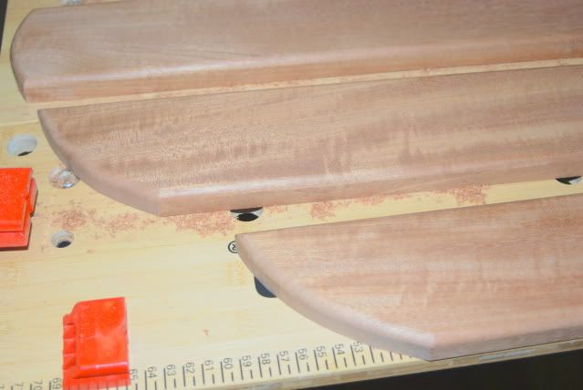

Once the slats were trimmed to the exact curve given by the template, I used a 1/4" roundover bit to round over the front side of the seat slate. I used bench cookies when routing the long runs on the seat slats, but I honestly felt I needed a more stable surface than the cookies when rounding over the curves. A couple fo clamps for that.
Here are the slats after rounding over.

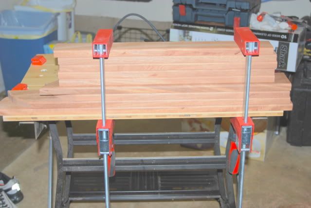

So thus far, I have the back seat slats completed (sans 1) and the seat slats.
I clamped them together to prevent twisting, and also to keep them safe in the garage.
Here are all the slats I've done so far. One is missing. It still needs to go through the surface planer.
Next time it's surface planing, jointing, and ripping all parts down to size.
