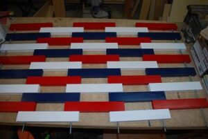

For my version of the wooden mat I stuck pretty close to the project design. Fortunately for me I had enough scrap pieces of 1×2 pine lumber that I was able to build this on the cheap. For this project you'll need to cut 36 - 9" pieces. To ensure that everything is consistent I used a stop block on my miter saw. I did this by clamping a scrap piece of wood on my miter saw and I made quick work out of this.

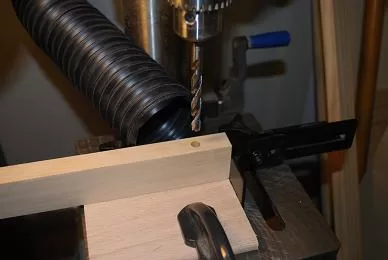

Next up, I needed to drill a hole in each end of the wood block. Using my drill press I drilled a total of 72 holes. Again I used a jig on my drill press to ensure I had consistent holes on each block. To drill the holes I used a 5/16" drill.

When it came to finishing up the wood I debated a little bit. I could use a simple deck stain and keeping the natural look of wood, or I could add a little color and hopefully avoid having to re stain every year. Ultimately I chose to paint my project with a Red, White, and Blue theme. To see more info on this project and additional pictures check out my entry over at: woodlogger
