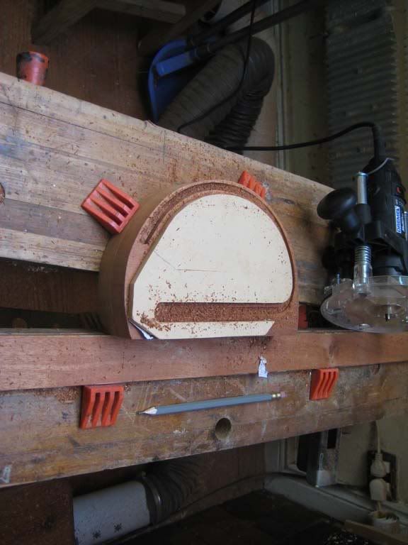

But this is the case. I followed Degoose instructions for cutting (drink twice, don´t bother to cut 20 times), and have a lot of fun. I routed the grooves with a dremel with the plunge attachment. After dry assembling, I made the drawer. It is only a one , so I hand dovetailed it.
I just added some inlays before cutting the slats, and changed the pull of the drawer for a brass one. Finished with sanding sealer.

The mechanism works well, with a clue. I forgot to mention in the description that I contact cemented a piece of anti-skid to the base of the box. I first try with only four piece in the corners, but were unable to hold in place the box when opening the drawer. Probably that was due to my own inexperience.

Lew, Charlie, and Puffin, the mechanism works well, with a clue. I forgot to mention in the description that I contact cemented a piece of anti-skid to the base of the box. I first try with only four piece in the corners, but were unable to hold in place the box when opening the drawer. Probably that was due to my own inexperience.
