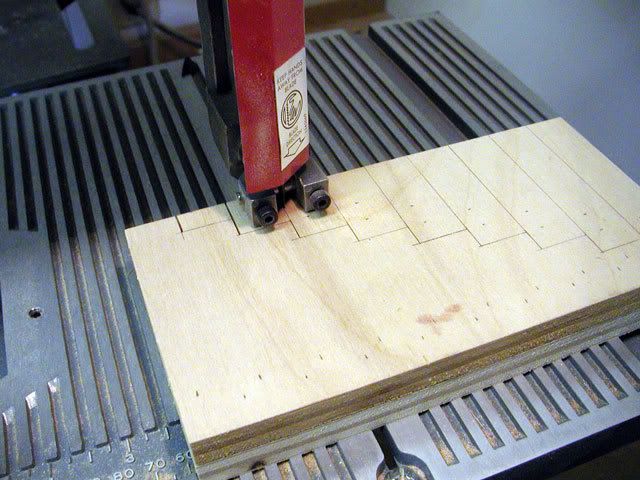

Cut the steps from 1/2" plywood. Use double sided tape to hold two pieces of wood together and cut them at the same time.
Lay out the cuts as follows: 3/8" up, 3/4" over, 3/8" up and 3/4" over. Continue this for 9 steps. The last flat should be 1/2". As a double check the back of the steps should be 3 3/4" high.

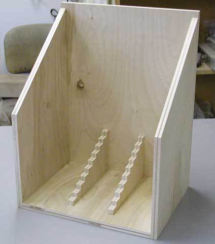

Start by putting the sides onto the bottom. Make them flush with the front and back.
Add the back.

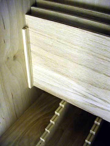

Put the steps against the back and bottom, centered 3" apart.
Now add the dividers. This works best with the box laying on its back. Glue spacers along the sides and dividers against the spacers and flush into the notch of the steps. I didn't nail these in but I did place some weight on them until they were dry.
