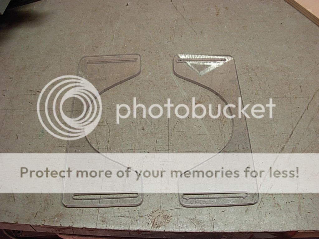

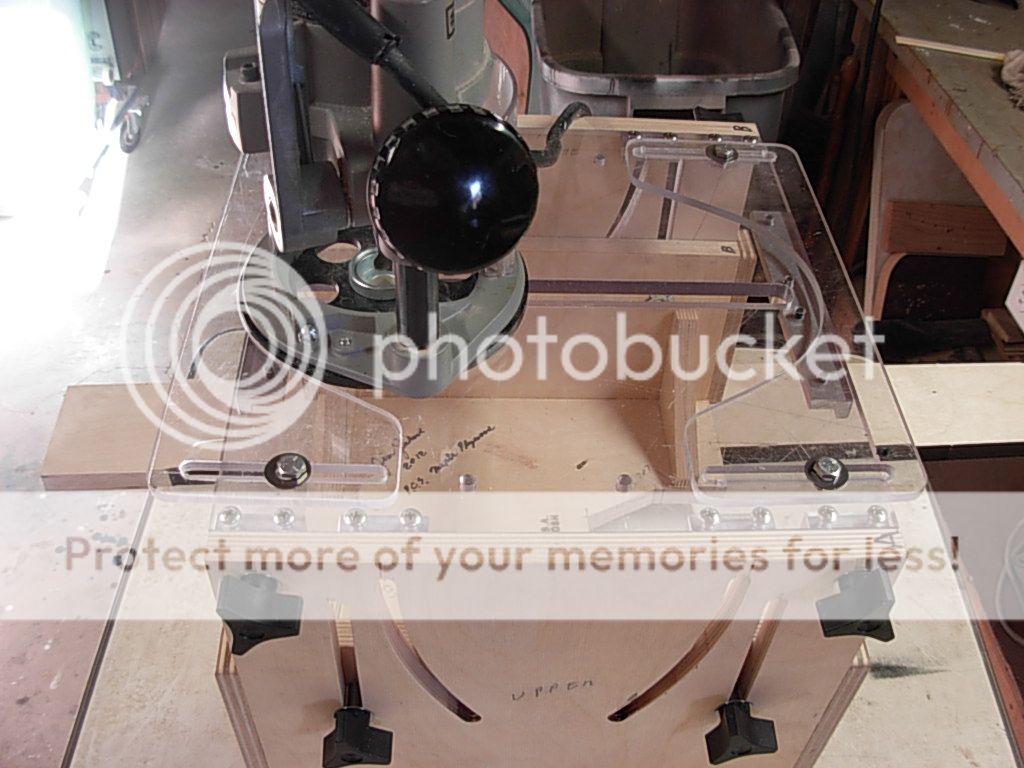

Well I finished the stops today. I made then out of 1/4 Lexan so I can see through them. They have adjustment slots and a dual pattern of holes so they can be moved even further that the slot allows. I needed them thin so they can clear the spring towers son the plunge router,
Here is what I came up with to limit the travel of the router in both directions:
