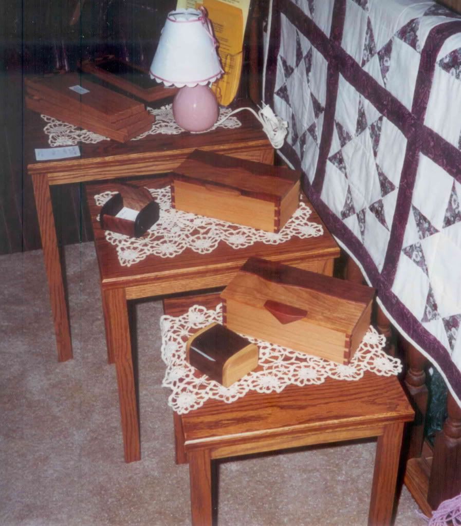

This is a photo my wife found (probably spring 1999) of two of the boxes I made, as well as bandsaw boxes, and a few of the inlaid stall plaques (for the equine industry), plus a set of nesting tables made of oak with an inlaid edge of pallet material.
She had taken all of these items to a relative's place who had a "home craft sale"... all she brought back was the box I posted above as I didn't want to sell it.
