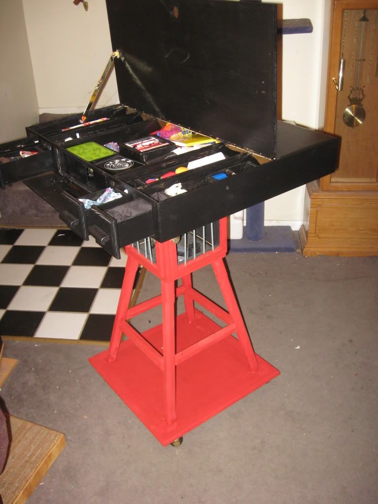

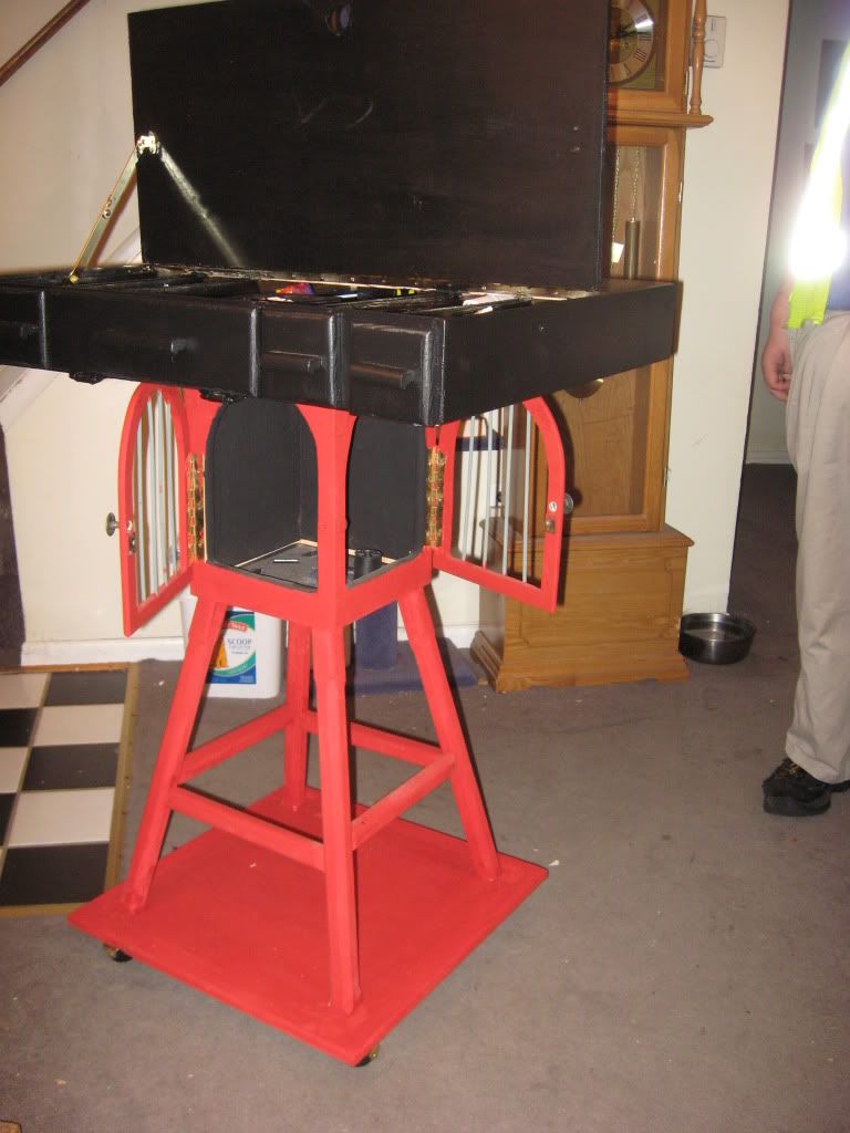

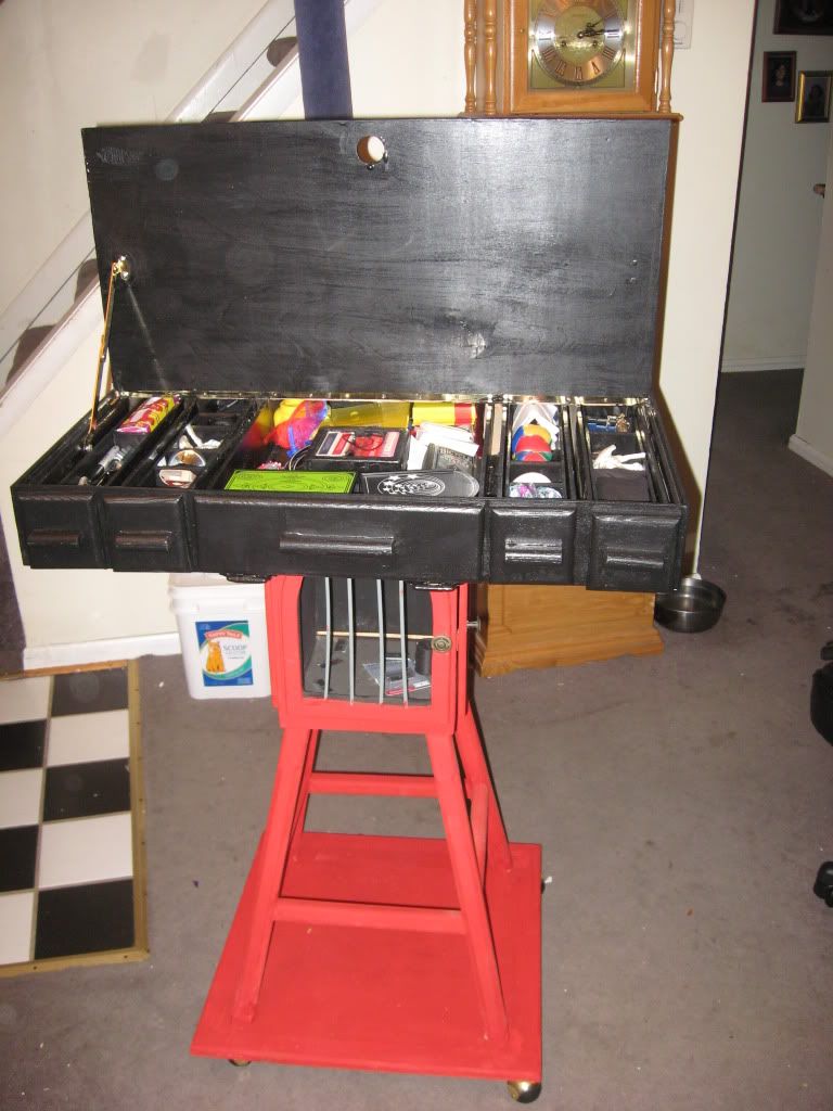

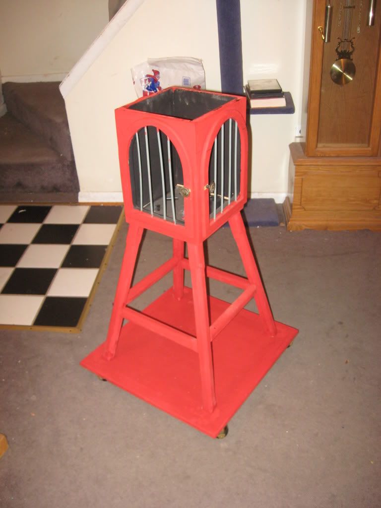

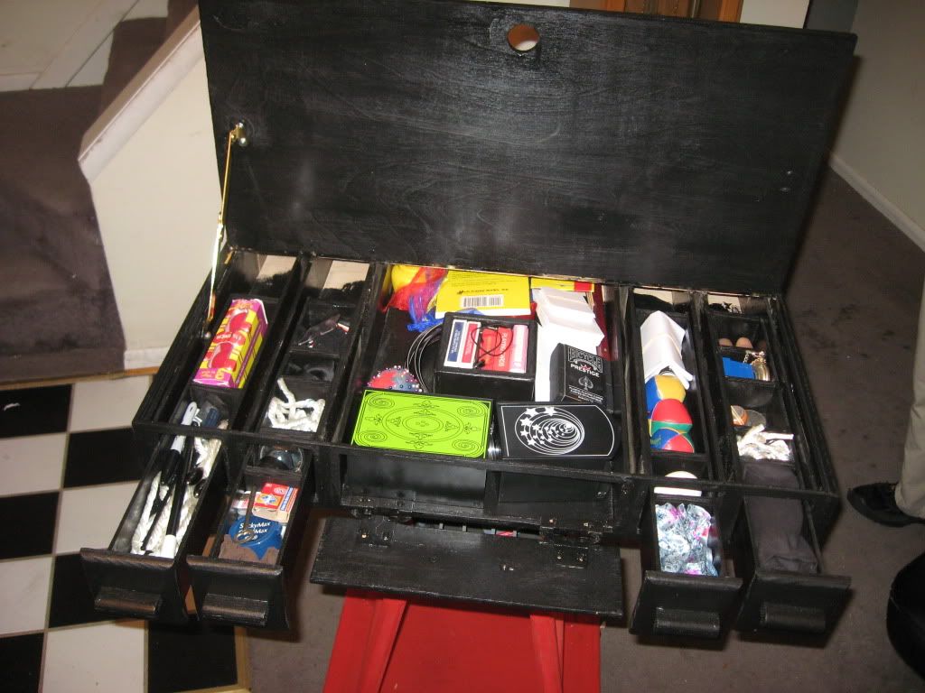

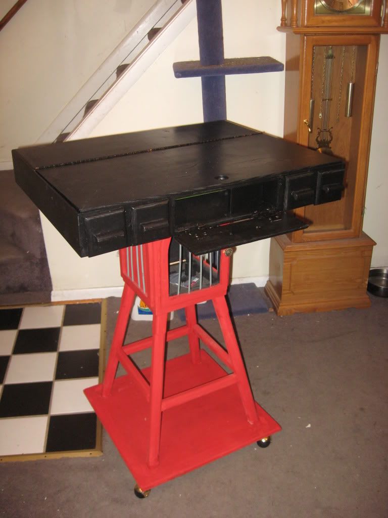

I just finished this Magic Table project for my Stepson, Bill. (He is the dude in the pictures) He is an amateur magician working his way through college at Drexel University in Philly.

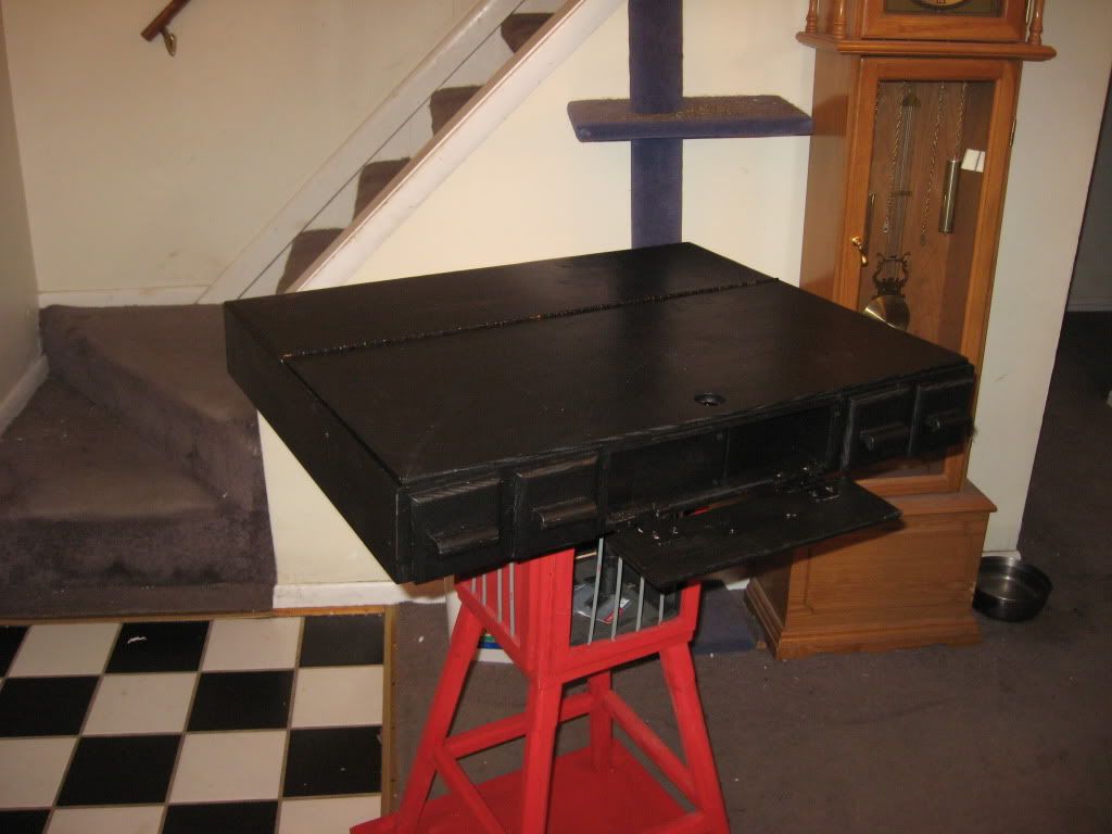

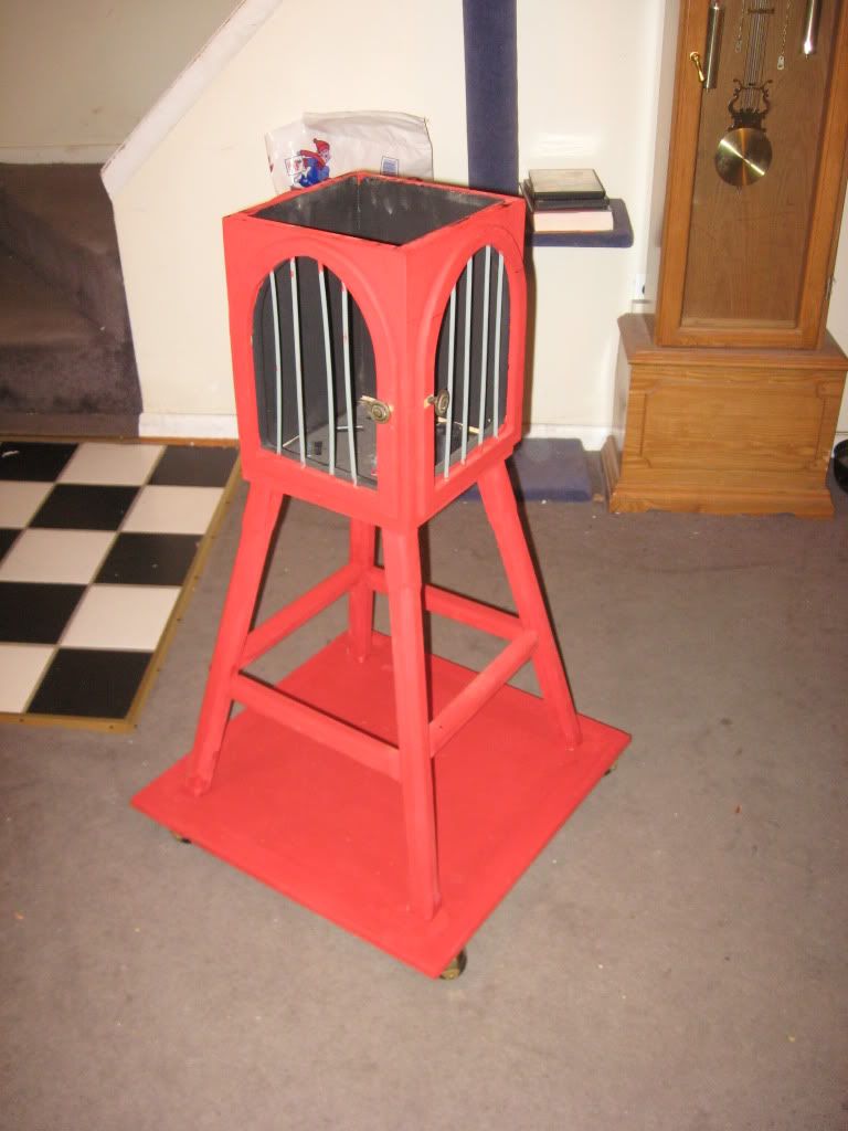

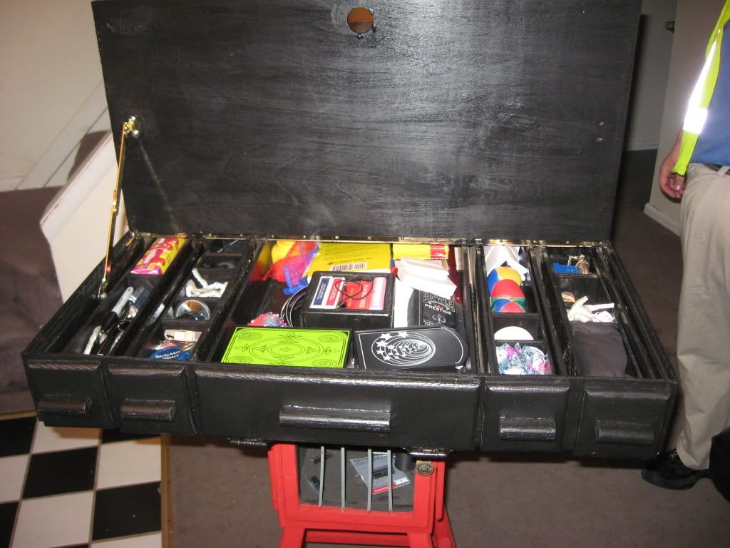

The base is 3/4 plywood, the legs are 2X4s ripped to 1 1/2X1 1/2. The top doors are 1/2 birch plywood with hardwood dowels as bars with a pine box. The Table is 1/2 in birch plywood made with routed rabbets. The drawers are 1/2 in plywood with hardboard dividers. I also did a sketch-up of this design from a very crude sketch Bill gave me. And he is studying to be an engineer, go figure! Bill likes it so much he wants me to advertise it and try to sell them to other aspiring magicians. Are there any out there who would like one of there very own? I work for wood!
Thanks for looking,
Ted
