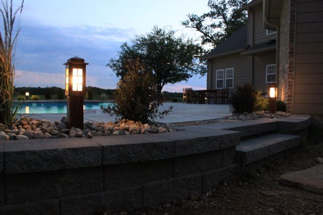

Well, we just installed a new pool. It's actually not even finished yet. After researching landscape lighting, I found out that you have to spend a lot of $$$ to get a high quality light fixture. Upwards of $100 or more per light. That adds up pretty fast. So, I built my own, out of cedar with a marine finish (5 coats of Epifanes Rapidclear) to withstand the salt (from the pool) and weather.
This project came from Woodsmith #141. Sanded plexiglass is used for the window panes. Followed the instructions pretty closely except for the light. In the magazine, a 20 watt automotive bulb was used. Trying to save energy, I used an led light. Each light uses 1 watt, and very close to the same brightness.
I built a total of 18 lights. (It was a lot!) Eleven of them are installed around the pool. The other seven will be installed along a path from the driveway to the pool. Not done yet.

Hardwired. 14ga low voltage cable to each one and a 12v power transformer on the side of my shop.

Unlike you, I have been buying those $30-$50 low voltage lights. Again and again. They're broken or sagging again and I'm sick of it. I only need 4, but I really don't want to pay triple digits for each light. They need to be able to at least handle a weed whacker and at most, falling pine cones (hopefully not a run away lawn mower).
Before I pay for the magazine, I am curious what the interior consists of? How is the wiring and fixture mounted? Metal conduit? Staked into the ground? etc… And is that info included in the plans?
Thanks
141 Posts
Well, let me start off by saying that it's been three years now, and they still look fairly tip-top. I brush a coat of finish on every spring and fall, and that keeps them looking new-ish.
The interior is pretty hollow, just a socket comes up with the bulb. I actually used a piece of copper (since it was easily pliable and I could squeeze the end with a pliers into a rectangle shape) to hold the socket. Works fine as long as you don't create a short. I cut a piece of pressure treated about 1 1/2" square and about 14" long and used that for a stake. I think the plans may have used a metal stake.
The plans provide quite a bit of detail for most of it. I switched it from incandescent to led. Links above.
