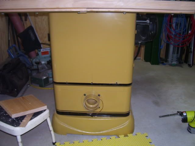

Here is a picture of the TS Cabinet before I drilled the holes and attached the ledge.

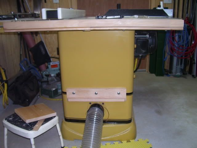

And here it is after the ledge has been bolted to the cabinet.

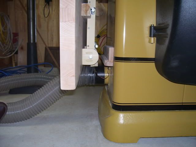

The table pivots on two 5" long lag screws that are screwed into a 5 ¾" wide mounting plate that in turn is mounted on the rear rail of the saw. This too required drilling. I drilled 5 holes in the rear rail for lag screws. I laminated two lengths of butcher block to build up the mounting plate to the height of the TS. The leg assembly swings on brackets mounted in the underside of the table.

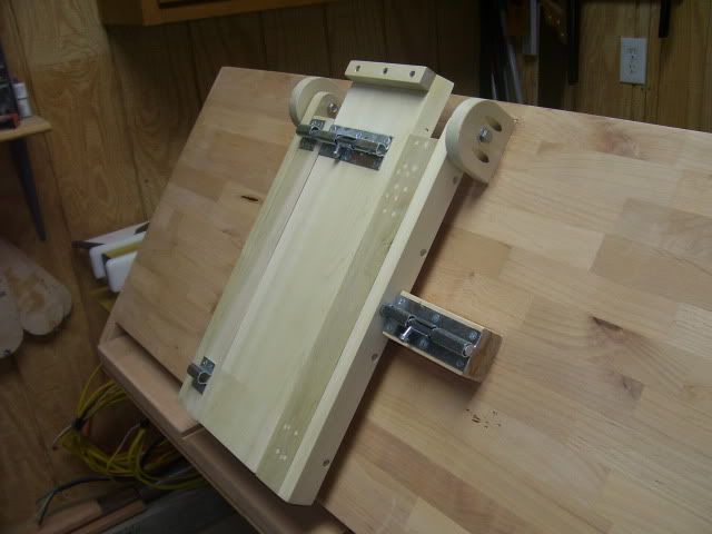

Here is a shot of the leg assembly in the closed position. I swung it up on top so you can see it. That piece of poplar is not diseased. I struggled to get the hardware placed just right and those are holes I filled after re-locating the hardware to the opposite side. You can also see that I used pocket screws to inset the brackets to the underside of the table.
The extension slides in what amounts to a long dovetail and then is held in place via a heavy duty deadbolt. It took quite a bit of finessing to get the table level while in the locked position. There is a bit of play in the deadbolt and placement is critical to assure a level table. The leg collapses and a second dead bolt holds it in place when the table is folded down.

And here in the folded down position. Note that the table is just barely above the DC hose.
