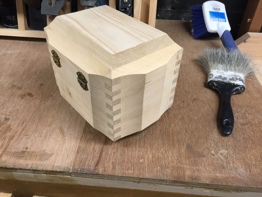

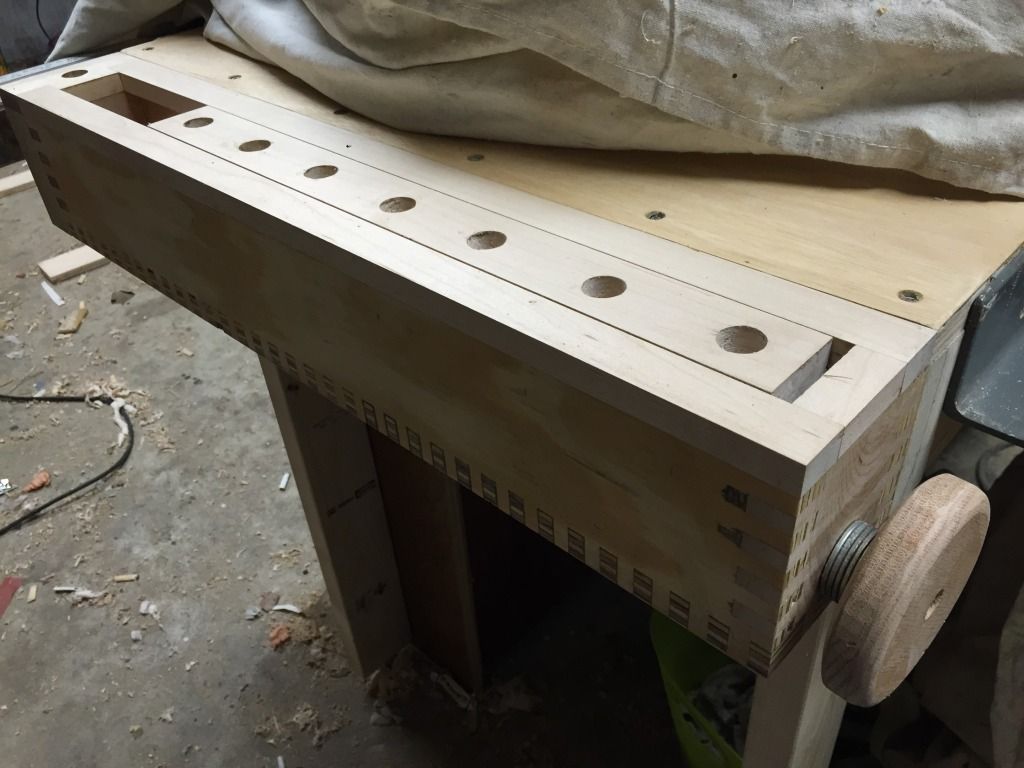

Just a couple things I've made with it while testing it out.
If the work piece is longer than 8", I cut the mating parts at the same time so the error over a long length doesn't matter. Learned that the hard way on my hybrid vise. I've had to use paint stirring sticks to prevent tear out after cutting joints as tall as I could make them in the beginning. 1/4" ply would work too. It's definitley opened up the possibilities of what I can do to add form and function to a project.
