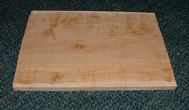

When I tried my Wood Slicer blade, I took this picture.
A nice clean cut.
