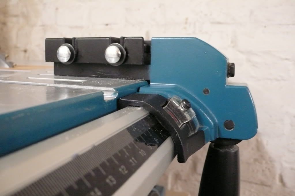

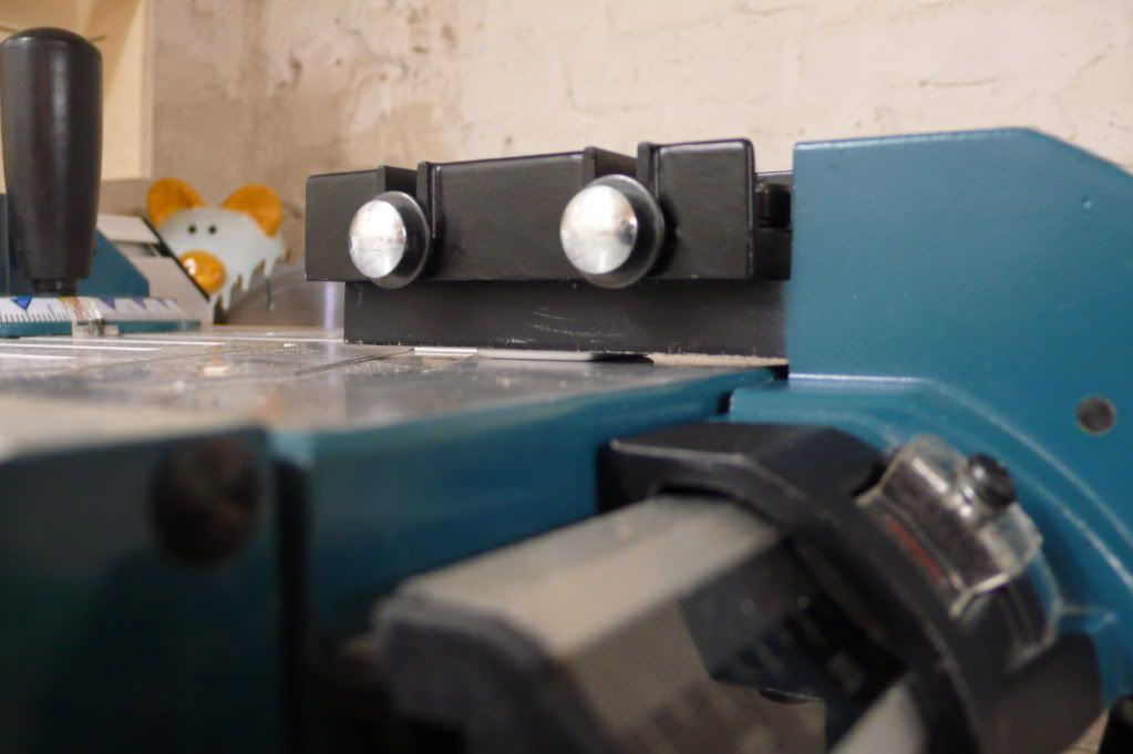

Rip Fence: Unlike other jobsite table saws the MLT Fence is only mounted on the front. Its mounting mechanism is cast aluminum. It runs on a small plastic base.
On top of it comes a adjustable part where the exdruded aluminum fence is attached with two screws. To my mind too many variables for a sturdy fence.
The aluminium fence with only 15mm (2/3 inch) is way to flexible. It barely makes it past the blade and doesn’t provide enough support for straight cuts.
Setting the fence up is a pain in the butt. The plastic base reflects the highs and lows in the surface. You have to adjust the fence in every position so it lays flat on the table.
The screws loosen after a couple cuts.
The mounting mechanism has play in every direction which may cause a non 90° angle to the surface. The easiest way to solve a few of these problems ist by taking the plastic base out and accept the wear and tear that the cast aluminium does to the table. The fence is still not stable when ripping longer boards and easily causes kick back. The way it is constructed it can be readjusted to be used on both sides.

Review Update:
Here you can see the rip fence mounting mechanism on the plastic base. The base lifts it of the rail and is so small that it hits all the highs and lows of the design slot you see in the next pictures and tends to tilt the fence.
With the base taken of you have more wear and tear but the mounting lays flat on the rail.
Here is the setup with out the extruded aluminum fence. To many variables of too small size for a sturdy fence.
Picture got cut off but you see all parts except the base.
