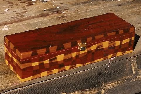

While my first attempt to make a cutting board was still drying from the last coat of finish a friend came by with four weathered director chairs and asked if I wanted them. I didn’t have a need for more outside chairs but an inspiration popped into my head to strip the chairs down and make cutting boards from whatever wood I could salvage from them. After taking all the fabric and hardware off I cut all the pieces into individual boards being careful to miss the nails,cracks and cut out all the mortise and tenon joints. Each little board was run through the drum sander to remove all the paint and to true up the wood. Then the many different glue ups (TiteBond III) to make the segmented planks then cutting all of those to small strips and then more glue ups. After all the strips were glued, (all end grain), and run through the drum sander for flattening then the table saw for squaring the sides. I added a border of oak and routed all the edges smooth. Several coats of finish and then abrading the surface with oooo steel wool to give a flat sheen to the cutting boards. This was a very enjoyable project watching something change into something else. (The bottom right board has 161 segments.)

Pretty cool. The one question I have is about the drum sander. I cant afford one and would love to have one. I have a set of plans for making one from wood but it has been sitting on the back burner for now. Question is, what kind of Drum Sander are others using? A bought one or shop built one? The one I have the plans for are from ShopNotes I believe. I guess two questions, since I am using my first planer, what is the difference in the results between the Drum Sander and the Planer? I see yours is bought Kindlingmaker.

twisted: the planer is grain oriented ,
the sander can ( and does ) flatten the same ,
but the grain can be from anywhere .
great for re-sawn and figured woods ,
an inlays .

here is a sled i used for some parts i re-sawed from 3/4” material ,
into 3 pieces , the final thickness was 3/16” , the grain was going whichever way ,
i did have to put stops to each piece , and remove all parts , after each pass ,
so thet the sawdust didn’t get under them and lift a corner .
i just use 80# sand belts on mine , any sanding marks , are easier to remove with a DA sander after the work is glued down . the planer would have left some pieces clean , some chipped up , and some lifted and destroyed completely .
here is another example of a glued up alternate wood and grain that made it thru the sander with flying colors ,
would it have made it thru the planer ?
