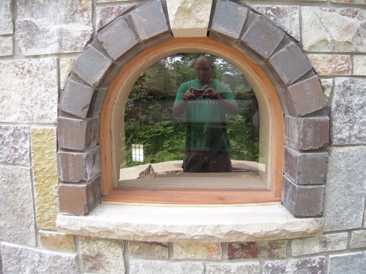

Here’s a picture of a window that I built earlier this year using 1/8” baltic birch plywood, and African mahogany using the bent lamination technique in my shop. The beveled leaded glass wasn’t yet installed, and they weren’t stained yet.
