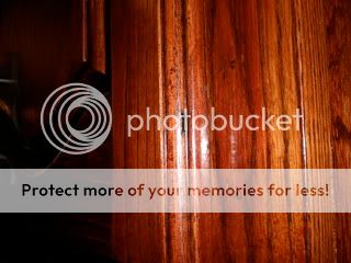

Are you going to make cabinets with face frames? The Blum Compact hinge works great! I used this type the first time I use Euro hinges and found them very easy to set up. I used 3/4” overlay hinges. Here is my first attempt.
