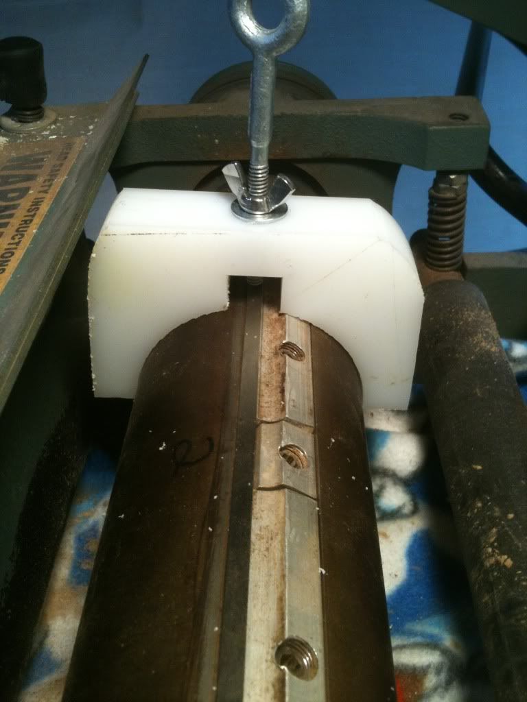

I know I could just go buy a knife setting jig, but some how spending $80+/- for something I’ll use once or twice a year just didn’t seem right. So I made my own.
First I found a piece of scrap cherry. I chose cherry because it was a piece of scrap the exact size I needed. I think its karma.
I then measured the width of the cutter head
I divided that in half and set my hole cutter to make the half circle.
A little sanding to get it just right.
Verified the fit.
Drilled for the knife groove. (note its slightly off center)
Cut out a pattern for a better look and feel.
Drilled for the adjustment screw.
Found 2 more pieces of scrap and glued them for reinforcing the jig with the short grain direction.
Tapped for the adjustment screw.
Added the adjustment screw, nut and washer.
The using a good old fashion feeler gauge, set the adjustment screw to the current level of one of the knives. I checked the rest to find they were right on the money. I never moved them during the restore, so the last guy set them perfect.
_
Set it off for the glue to dry.
The final steps were some light sanding and a coat of BLO, and resetting for blade height.

don I’m confused. Does the jig index off the cutting head or the plate that seems to surround the head. If it indexs off the head then the same design could be used for a jointer. I will give it a try, thanks phil
View Don W's profile
Don W
19993 posts in 3625 days
#6 posted 07-26-2012 05:29 PM
it indexs off the cutting head
