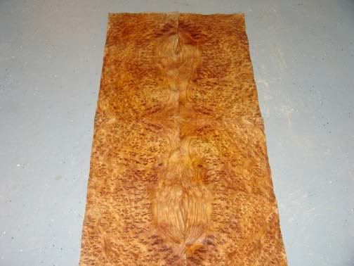

The top photo is a couple sample packs of sequenced matched veneers from Woodcraft supply.
The secong photo is bookmatched Camphor veneer.
The third photo is Bruce holding a sample of Avodire Crotch veneer, with No Finish on it.

You know have a perfectly uniform pack of veneer, which is ready to be joined. Decide on the pettern you want. To make a four way book match, open the pieces like a book. The four identicle corners will be in the center of the panel. See the photo of the Camphor veneer. These pieces are just lying next to each other, so dont inspect the joints.

That Avodire is amazing, wow, people seem to describe it as a lighter mahogany so I’m surprised by how deep the tone is.
