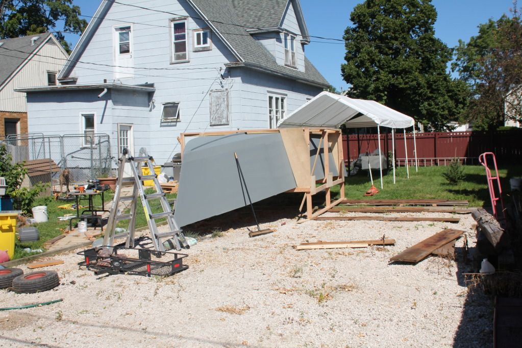

I’ve done a good bit of research on the flip. I plan to build a cradle around the boat similar to this.
While it is in the cradle upside down I plan to remove the legs from the strong-back that it’s on now in my shop.
I hope at this point that I can get enough help from my neighbors to lift it up and flip it onto it’s side. Then with a rope connected to my truck control the last 90 degrees to the ground. If I can’t get enough help. I will then build a gantry similar to this and use two chain hoists connected to the cradle.
