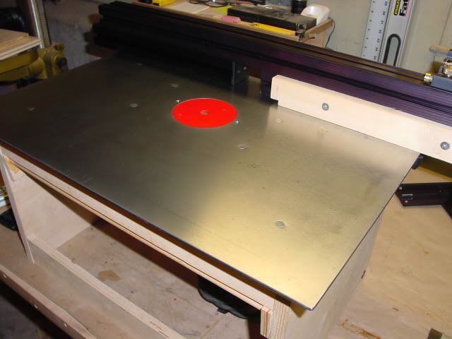

I have been busy working on my router table..
I milled a replacement piece for the base from 3/4 Baltic, re aligned all the other base pieces and tightened up all the tension rods in the base. I picked up some Merlon abrasive pads to polish the top with. The grits were 360, 1500, 2600. I cut the pads into squares and used my ROS to polish with. It worked well, but the ROS really destroyed the pads….I don’t think the y were made for a power sander. I wiped it down with mineral spirits between grits. Then after the polishing, my usual coat of wax from some crupled up wax paper..I think maybe on this I might get some renaissance wax..I think its looking much better..
I also contacted Lee Valley/Veritas about replacement parts and they responded the next day with an order number and I would be contacted by the fulfillment dept about prices and shipping.
