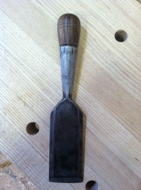

Brandon.. The business end of the 2” chisel is ground into a slight radius. First saw it done on a 2” chisel used by Willard Hamner a Guideboat builder in the Adirondack mountains of NY. He was a builder in the early 1900’s. And most slicks also have a radius. Here is the whole chisel.
